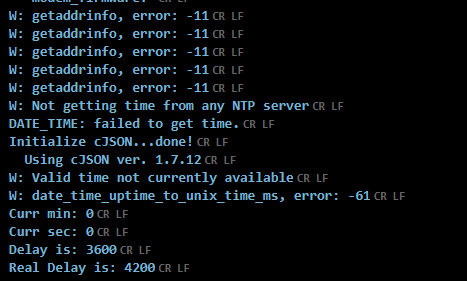

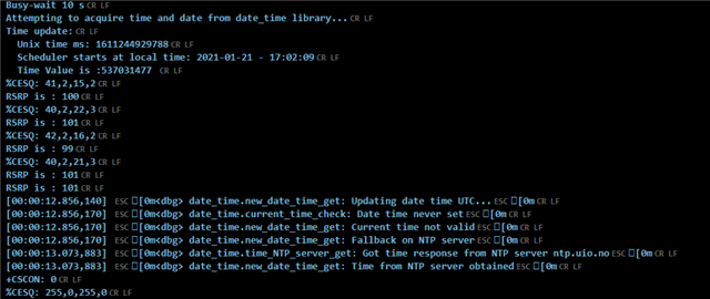

  • Hi Carl,
    I had a question regarding this ticket. The above code that you sent worked perfectly for NCS v1.3.0 .
    I did this in NCS v1.3.0 and this works perfectly.
    	modem_configure();  //to get LTE connection
        date_time_update(); //To get current time
        printk("Busy-wait %u s\n", BUSY_WAIT_S);
        k_busy_wait(BUSY_WAIT_S * USEC_PER_SEC);  //2 seconds delay
        int64_t curr_time;     //above code
        date_time_now(&curr_time);
        int64_t curr_time_s = curr_time / 1000;            //Convert to seconds
        struct tm *readable_time = gmtime(&(curr_time_s)); //Get human readable time with time.h
        printk("Curr min: %d\n", readable_time->tm_min);
        printk("Curr sec: %d\n", readable_time->tm_sec);
        int32_t delay = 3600 - (readable_time->tm_min) * 60 - readable_time->tm_sec;
        int32_t real_time = delay + 600;
        printk("Delay is: %d\n", delay);
        printk("Real Delay is: %d\n", real_time);
    The above output is correct.
    But when I try to do the same in NCS v1.4.2 or NCS v1.5.0, it doesn't work the way I want it to.
    	modem_configure(); //for LTE connection
        date_time_update_async(NULL);  //to get current time
        int32_t real_time = delay + 300;
    The only change is using : date_time_update_async(NULL) as date_time_update() is not supported in higher NCS versions.
    I get the following in NCS v1.5.0 :
    This output is incorrect (the Curr min and Curr sec are wrong).
    Could you try to reproduce this in NCS v1.5.0 and verify ?
    Adeel.

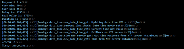

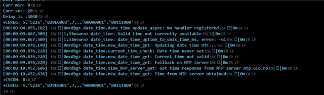

  • Hi, Adeel!
    You're getting an error when calling date_time_now that indicates that a valid time aren't available yet. Instead of busy_wait I suggest that you use a blocking semaphore that is released by a handler for date_time_update_async callbacks. This way you can ensure that a valid time is available when calling date_time_now.
    You can how I have done this here.
    Carl Richard
  • Hi Carl,
    Thanks for this lead. Got it working by using the blocking semaphore Slight smile.
    Adeel.
