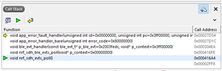

Call stack shown below after Fatal error:

    The application should not crash even if the client is sending a packet that is too long. From the stack trace you posted, it appears that the error is occuring in your ble_evt_handler() (likely means an error code passed to one of the APP_ERROR_CHECK() macros). Are you able to tell which one of the functions inside this handler returned the error code?

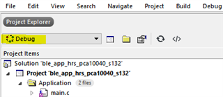

    Do you have logging enabled in your project? In that case, please make sure the "Debug" configuration is selected as that will make the fault handler produce more detailed crash log.
    Yes It is sd_ble_gatts_rw_authorize_reply(p_ble_evt->evt.gatts_evt.conn_handle, &auth_reply) return the error in ble_evt_handler().
    case BLE_GATTS_EVT_RW_AUTHORIZE_REQUEST:
        ble_gatts_evt_rw_authorize_request_t req;
        ble_gatts_rw_authorize_reply_params_t auth_reply;
       req = p_ble_evt->evt.gatts_evt.params.authorize_request;
      if (req.type != BLE_GATTS_AUTHORIZE_TYPE_INVALID)
       if ((req.request.write.op == BLE_GATTS_OP_PREP_WRITE_REQ) ||
       (req.request.write.op == BLE_GATTS_OP_EXEC_WRITE_REQ_NOW) ||
       (req.request.write.op == BLE_GATTS_OP_EXEC_WRITE_REQ_CANCEL))
      if (req.type == BLE_GATTS_AUTHORIZE_TYPE_WRITE)
        auth_reply.type = BLE_GATTS_AUTHORIZE_TYPE_WRITE;
      else
       auth_reply.type = BLE_GATTS_AUTHORIZE_TYPE_READ;
      auth_reply.params.write.gatt_status = APP_FEATURE_NOT_SUPPORTED;
      err_code = sd_ble_gatts_rw_authorize_reply(p_ble_evt->evt.gatts_evt.conn_handle,&auth_reply);
    } break;
    I print the log by comment out APP_ERROR_CHECK()-
    00> <info> app: req.type=2,req.request.write.op=4
    00> <info> app: err_code=0
    00> <info> app: req.type=2,req.request.write.op=5
    00> <info> app: err_code=7
    Thanks. So it looks like you are encountering the same problem as reporter in this post: https://devzone.nordicsemi.com/f/nordic-q-a/61416/hard-fault-in-examples-peripheral-usbd_ble_uart-when-mtu-is-exceeded/250363#250363.  Please try implement the change I proposed there.
