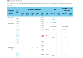

nRF52832 rev 2 vs rev 1 software compatibility with sdk, library
I have an existing product using the nRF52832 SoC rev 1.  We must transition to rev2 since rev1 is no longer sold.  We use SDK12.0.0, with S132 V3.0.0.  Have these software components been tested on rev2?
