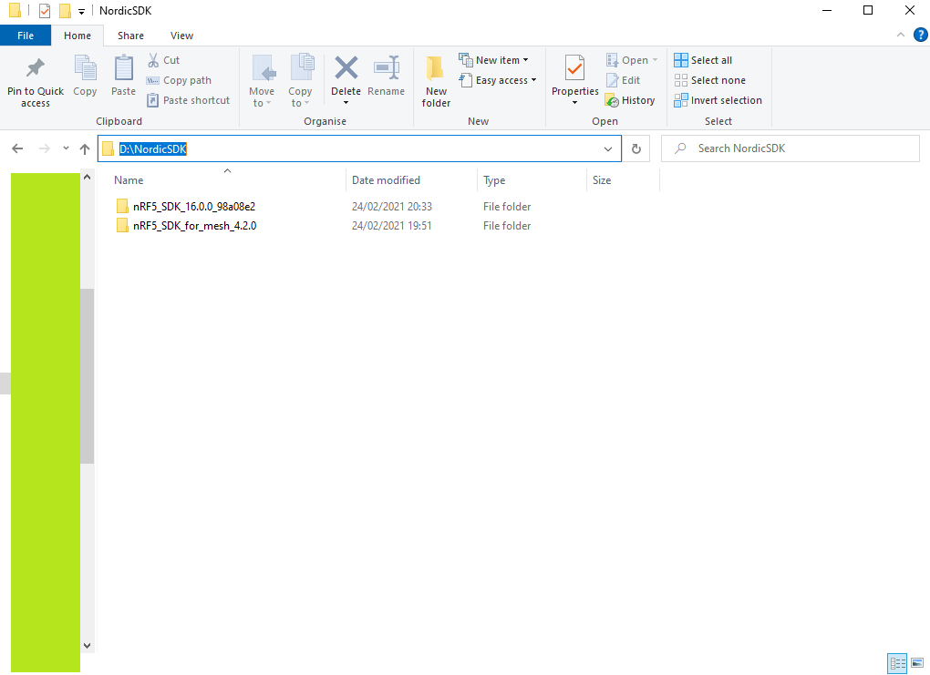

    I have tried to place both nRFSDK and mesh SDK in the same directory as suggested in the Getting Started guide. Here is the screenshot of the directory.
    And I had tried to add the SDK_ROOT while running the cmake. But still getting the same error:
    D:\NordicSDK\nRF5_SDK_for_mesh_4.2.0\build>cmake -GNinja -DSDK_ROOT=C:/NordicSDK/ ..

  • Hi Siew,
    Please try cmake -GNinja -DSDK_ROOT=C:/NordicSDK/nrf5_SDK_16.0.0_98a08e2/ ..
    You need to point to the nRF5SDK not just the parent folder.
