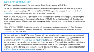

I've checked the datasheet for the ISP1807 and I cannot see anything special about those pins. I've looked at the product spec for the NRF52840 and I cannot see anything (but maybe I've missed something).
I cannot understand why I can pull the pin high with the internal pull up, but I cannot set it high with nrf_gpio_pin_set.
Any suggestions are greatly appreciated.
Pins 2,4, 6 are at the bottom of this image.
Parents Reply
  • Thanks, 10uA is a bit more than I expected but I've got pull-ups so there's probably no leakage across those pins. But you’ve reminded me that I really need to power profile ASAP (with my shiny new nordic power profiler 2!)
    I’ve not had any problems using i2c with these pins. So the extra capacitance doesn’t seem to be a problem. The rest of the board was completely fine thankfully.
    I’m very grateful for your help with this. I had never considered the possibility that the pins were preconfigured in this way. I think it would be very helpful to add something to the GPIO section of the product specification.
