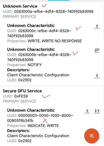

Hi All,
I want to use DFU to update the firmware from central to peripheral over BLE ,  both central master and peripheral are nrf52840.
Central master can find unknown service(0263000a..) and its characteristics (0x0b and 0x0c)  and DFU service (0xfe59) on peripheral but the volid characteristics of DFU can't be found.
Just a charateristic which uuid is 0 is found.
logs are below

 peripheral service and characteristics are below
I have no idea of why DFU characteristics can't be found . Please give me some advice.

    Could you let me know how did you do the service discovery ?
    Please note that the DFU service has different UUID to the NUS service. So you would need to feed the base UUID to the softdevice by calling sd_ble_uuid_vs_add() similar to what implemented in ble_nus_c.c make sure you used the uuid_type returned from that function as the input for ble_db_discovery_evt_register() calls.

  • I've solved this problem,  the DFU service and its characteristics are not based on the same service.
    In my first picture,  I changed the characteristic's base UUID as same as DFU service base UUID but the program has some bugs which cause the characteristic UUID not to be read.

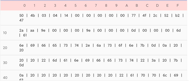

    The peripheral has bootloader, my work is sending image from central master(nrf52840) to peripheral and bootloader will handle the reciving of the image. The image has been stored in master Flash(GD25VE16C) as below
