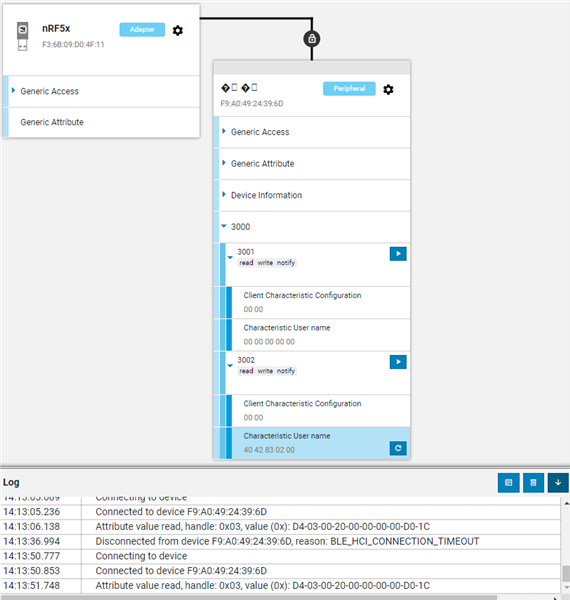

    Note the following changes that is made to BLEGattsCharMD in ble_driver.py:
    class BLEGattsCharMD(object):
        def __init__(self, char_props, user_desc=None, pf=None,
                     desc_md=None, cccd_md=None, sccd_md=None):
            assert isinstance(char_props, BLEGattCharProps)
            self.char_props = char_props
            self.user_desc = user_desc
            self.pf = pf
            self.desc_md = desc_md
            self.cccd_md = cccd_md
            self.sccd_md = sccd_md
        def __str__(self):
            return str(self.__dict__)
        def to_c(self):
            char_md = driver.ble_gatts_char_md_t()
            char_md.char_props = self.char_props.to_c()
            if self.user_desc:
                user_desc_array=util.list_to_uint8_array(self.user_desc)
                user_desc_array_cast = user_desc_array.cast()
                char_md.p_char_user_desc = user_desc_array_cast
                char_md.char_user_desc_size = len(self.user_desc)
                char_md.char_user_desc_max_size = len(self.user_desc)
            if self.pf:
                char_md.p_char_pf = self.pf.to_c()
            if self.desc_md:
                char_md.user_desc_md = self.desc_md.to_c()
            if self.cccd_md:
                char_md.p_cccd_md = self.cccd_md.to_c()
            if self.sccd_md:
                char_md.p_sccd_md = self.sccd_md.to_c()
            return char_md
    nRF Connect shows the following in Characteristic User Name:

  • Oh, that didn't look too good. I am running Ubuntu 20.04.2 LTS, Python 3.8.5.
    Edit: And just to be clear, the version of pc-ble-driver-py is 0.15.0
  • In my other issue there is also garbage showing up. Maybe these two issues are related: devzone.nordicsemi.com/.../device-name-shows-garbage-using-pc_ble_driver_py
