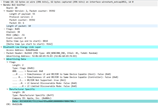

I found that the advertisement packet from my BLE tag are not received at BLE_GAP_EVT_ADV_REPORT event for a while(about 50 sec) and  after that adv packet are received about 50 secs and then no adv... from my tag while other adv packet received well.
At this time, my cellphone appl. made by Nordic receives the all adv packets which are lost at my scanner.
My tag sends adv packet every 5 secs.
Scanner scanner is set to scan interval == scan window.
What is the problem?

  • This is capture by wireshark, ADV packet which can not detect my scanner
  • Have you tried to change scan window and scan interval? What timeout have you set when scanning? For instance you can set timeout to 0 to scan infinitely. Do you have other BLE channels while scanning here?
