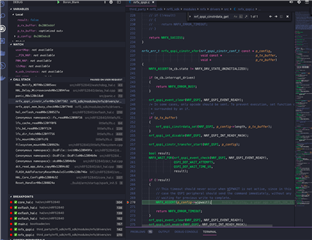

Dear Nordic,
I have a 4MB external flash on my board, I've successfully run the code on it by using XIP. However, I got stuck when I was trying to read back data from external flash. The following picture has the call stack trace. It's a failure of NRFX_ASSERT.
Some more details:
Using nrfx driver both in bootloader and application is not a good idea, because the driver status is stored in the different RAM area. I add a fake initialization function for QSPI to keep the peripheral status consistent. Do you have any better ideas?
