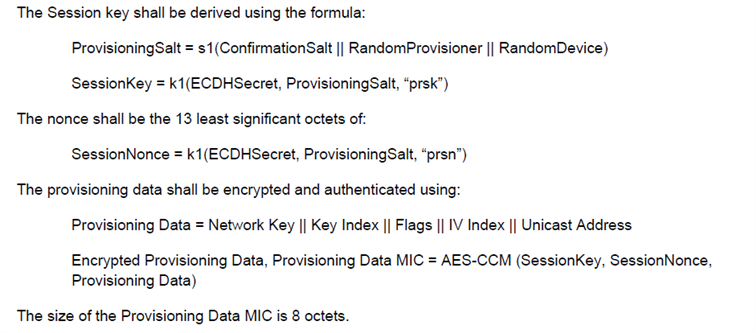

 3. Can you please give me the difference between aes CCM and edch. Because I am little confused which algorithm I need to use for security procedure.

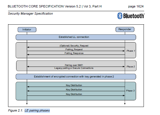

    Pairing and bonding are almost the same process, the only difference is that with pairing, the LTK (long term key) is not generated/reused like with bonding. So with pairing, the pairing process will need to be executed every time the connection is established/reconnected.
    You can find the example of bonding and pairing in any of our example, for example ble_app_proximity, or ble_app_gls (with passkey).
    The actual encryption is handled inside the softdevice so you don't need to handle that.
    Please let us know what exactly you want to do or if you have a particular question.

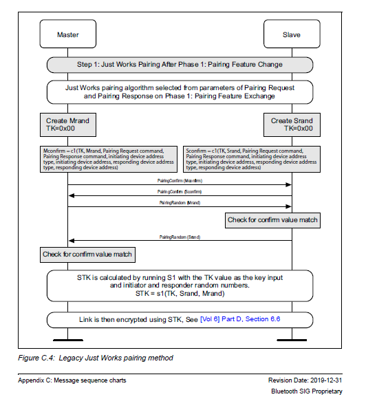

    If you want to study how the pairing and encryption work I would suggest ot have a look at the spec, for example Chapter 2 Security Manager in Vol 3 Part H Bluetooth Core Specification v5.2 :
    Phase 2 (page 1696):
