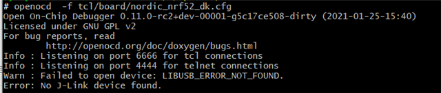

i'm trying to connect openocd using Jlink of nrf52833 DK, but it does not work.
i installed openocd in MSYS in win10 environment and also installed seagger Jlink driver.
It doesn't work like the picture above.
How solve it?

OpenOCD requires the WinUSB driver in stead of the SEGGER driver.
Use ZADIG to replace the SEGGER driver with the WinUSB driver.
