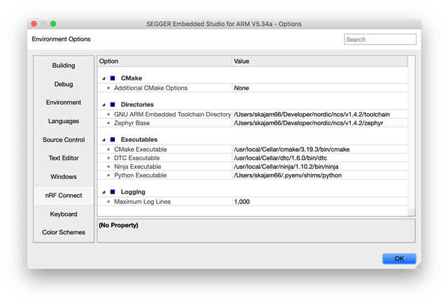

My first step was to make an exact copy of /opt/nordic.* on a network drive and rename /opt/nordic to /opt/xxxnordic to ensure that nothing is being used from that installation.  In SES, I changed the setting in Tools->Options as shown:

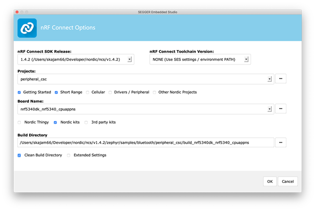

Here, "pip" is pip 20.3.3 - the version installed for python 3.9.1.  I then tried to import an nRF SDK project with File->Open nRF SDK Connect Project.  Connect Option settings are:

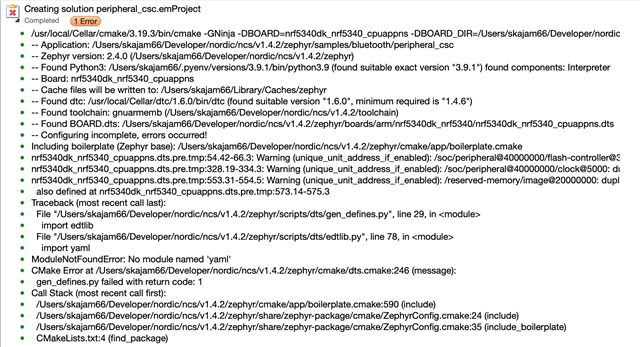

This fails while building the build files. Log output is:
The error says the python module yaml cannot be found. However, the discovered version of python is 3.9.1 as expected and yaml most certainly is installed in this python version:
