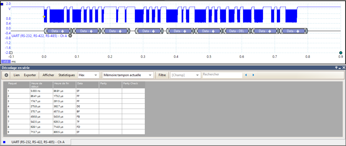

Because of experiencing stability issues using the app_uart implementation for UART communication, I recently switched to the libuarte_async lib which works like a charm when dealing with reception of data. I started from the libuarte example from SDK 17.0.2 with dev board pca10040.
receiving data is always consistent, but whenever I want to send data, it actually sends random bytes instead (but the correct number of bytes).

    uint8_t data[] = {0x41,0x54,0x2B,0x51,0x43,0x43,0x49,0x44,0x0D};
    ret = nrf_libuarte_async_tx(&libuarte, data, sizeof(data));
    APP_ERROR_CHECK(ret);
    while (true)
        NRF_LOG_FLUSH();
And uart instance is created this way:
NRF_LIBUARTE_ASYNC_DEFINE(libuarte, 0, 0, 0, NRF_LIBUARTE_PERIPHERAL_NOT_USED, 255, 3);
Any idea what could be the issue?
