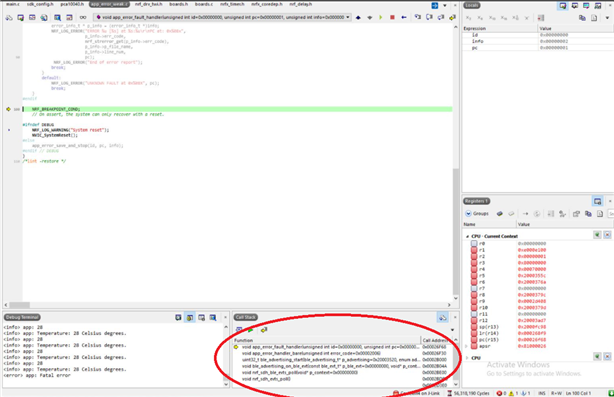

  • Enable the DEBUG preprecessor flagIf you can start your program in debugger, you should be able to see the call trace when the hit the breakpoint of the error like this
  • My file does not have that. s130 for soft device and SDK 12.3.0.

    It looks like I have to set a DEBUG preprocessor somewhere. The preprocessor list in Keil is one of the most user-unfriendly interfaces I have seen. One line of limited size where one has to enter one after the other. Horrible. Perhaps there is another way?
  • I just added the preprocessor in that ugly line. What I found was that the method sd_app_evt_wait() returns error code 2 which is NRF_ERROR_SVC_HANDLER_MISSING. I did not check for any error codes on this method because the documentation states it only returns NRF_SUCCESS.
    Opps, error 2 is NRF_ERROR_SOFTDEVICE_NOT_ENABLED. Of course it is disabled. I disabled it. So how do I handle that final for(;;) loop? Should I just return and exit main?
