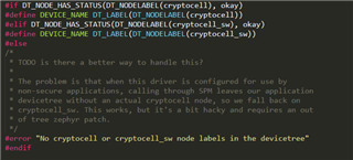

Hi, I am building an application on the nrf5340dk using using nrf5340dk_nrf5340_cpuappns as the target board.
When I have CONFIG_NETWORKING=Y enabled in my prj.conf I am getting this build error:
#error "No cryptocell or cryptocell_sw node labels in the devicetree
From the source file entropy_cc310.c
I realize that the non-secure app has to call the cc312 driver through the SPM services.
However looking in the file spm/Kconfig i found:
config SPM_SERVICE_RNG
    bool "Request random numbers"
    default y if SPM
    select NORDIC_SECURITY_BACKEND if IS_SPM
    select FPU if IS_SPM
# NORDIC_SECURITY_BACKEND is not supported on 53 yet
    depends on ! SOC_NRF5340_CPUAPP
    help
      The Non-Secure Firmware is not allowed to use the crypto hardware.
      This service allows it to request random numbers from the SPM.
Yet it seems that that the SPM_SERVICE_RNG is currently not allowed on the nrf53 for some reason.
Can you better help me understand the issue here, and if there is a workaround. Thanks.
