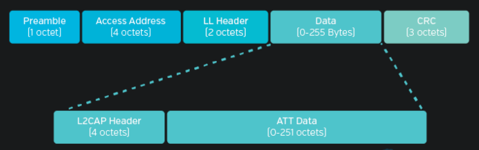

    So My query:
    If i set ATT MTU 247 and Gap Data Length 251
    How many packets will send in one connection interval(7.5ms) on 1m distance as well as 12m distance with worst condition. Is characteristic value data payload and (ATT_MTU-3) & (GAP Data length = ATT_MTU+4)should be same.
    If i set ATT MTU 40 and Gap Data Length 44
    what is the maximum time required to send one packet of 40bytes. is it varies according to environment surrounding.
    According to softdevice s132 document(S132_SDS_v7.1.pdf) what do you mean by application can configure tndist on page 54. If so, how we can do that?
    Instead of sending 1ms if i send 111bytes every 3ms can i achieve constant throughput till 11m on worst condition.
    Please suggest the best possible configuration need to send data 37bytes in 1ms , 74bytes in 2ms or 111bytes in 3ms.
  • Pavan,
     For a 1M PHY, if you have 247 ATT MTU size then
    The total BLE packet size will be (1 + 4 + 2 + (4 + 247) + 3) = 261 bytes = 2088 bits.
    On a 1 MPHY this will take just over 2ms to transmit one packet and i think the best case is you can transmit two such packets within a connection interval of 7.3ms.
    We cannot say the average values per given conditions but there are some benchmark numbers that we have done which can be found here.
