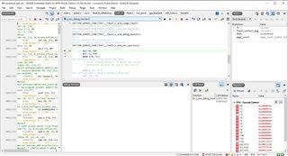

I went down the system at the point (A), so I fixed it.
&buf --> buf
(B) was fix as well, but the system goes down.

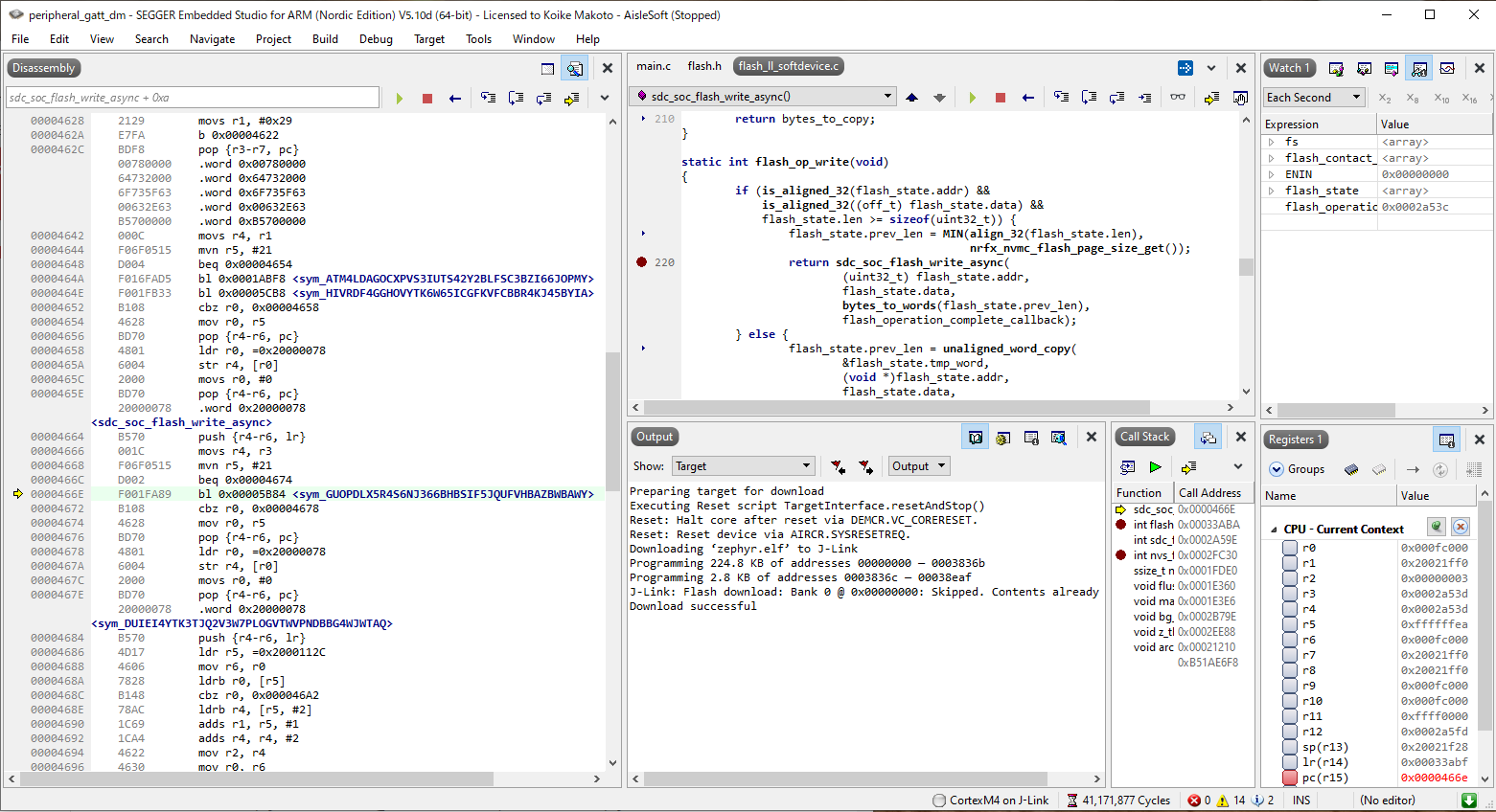

sdc_soc_flash_write_async to the point where it is falling in the function.
The attachment is stuck at 0x0000466E, but the next time you go with F10, the system goes down.
     are there any error codes? Do you have a log output?
  • On the nRF9160 side, flash writing is successful.
    I tried to find out what was different.
    nvs_fs.flash_device.api-> write functions are different.
    z_impl_flash_write API that writes in a function is called.
    On the nRF9160 side flash_nrf_write is called. This will be written successfully.
    On the nRF52890 side sdc_flash_write is called. This one sdc_soc_flash_write_async with a hand.
