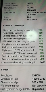

I want to use long range ble for advertising with nrf52833. I have a PCA10100 SDK board, and I'm running a program with type of BLE_GAP_ADV_TYPE_EXTENDED_NONCONNECTABLE_SCANNABLE_UNDIRECTED. Then I use nrf_connect for andrio in a mobile phone to scan for it. I have seen the device information of the phone and found that it surported long range(PHY Coded). but I can't scan my PCA10100 SDK. What reason is it?
    1: Are you sure your phone supports CODED_PHY scanning? Just make sure, and please note that even though your phone says Bluetooth 5 is supported, it doesn't mean it can use BLE Long Range.
    2: Does your device start advertising? Does the advertising start function return NRF_SUCCESS?

        The first image is Device Information of nrf_connect,It show long range is surported. The second and third image is the energy profiler of nrf52833 when it is advertising.
  • I believe that there is a bug in nRF Connect for Android that causes it to say that all Bluetooth 5 features (Long range included) is supported as long as the phone supports Bluetooth 5. Since all Bluetooth 5 features, such as long range and high speed (2M) are optional, it is not given that all of them are supported.
    Can you share the snippets used to start advertising? And also please confirm that your call to sd_ble_gap_adv_start() (probably through ble_advertising_start() or advertising_start()) returns NRF_SUCCESS.
