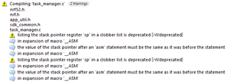

Warning when compiling task_manager
Hello Dear Developers!
I have a warning when I compile Task Manager
The warning is generated at this code in cmsis_gcc.h file:
__attribute__( ( always_inline ) ) __STATIC_INLINE void __set_PSP(uint32_t topOfProcStack)
  __ASM volatile ("MSR psp, %0\n" : : "r" (topOfProcStack) : "sp");
Despite this my program with Task Manager works fine. But could you tell me if this could lead to potential problems?
Environment:
  • NRF5 SDK 16.0.0
  • SES 5.32
  • nrf52832
