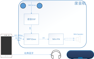

Dears,
Diagram as attached, we want to make a audio recorder design.
Customer wants to recorder the audio, and at the same time do audio player works.
Is it possible? waiting for your comments. thanks a lot.

Hi
I don't think this will be possible. BLE is not very well suited for large data throughput like streaming audio will require, especially if you are communicating both ways, as that would mean the nRF would have to switch between receiving and transmitting data while trying to keep up 2MBPS throughput.
Simon
