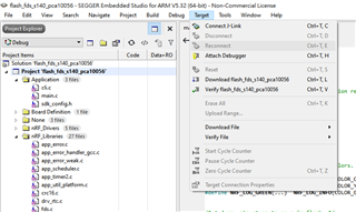

  • Hi Charlie,
    Right , that is for erase all, and  where can I find option to "west flash --erase ", I cannot find it with SES V5.32 as attached picture.
    thanks
  • Sorry for the confusion. West is a command tool from NCS/Zephyr.
