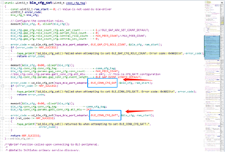

My Question is how to increase the ble link.
After i set the "ble_cfg.conn_cfg.params.gap_conn_cfg.conn_count = 3 or larger"  it will report NRF_ERROR_RESOURCES.
How to increase the controller ram for fixing this issue? or how to increase the ble link?
Actually. i need to implement multi-link in my windows's ble central. is there any way to fix this issue?
Thanks for Nordic Team.

  • static uint32_t ble_cfg_set(uint8_t conn_cfg_tag)
    const uint32_t ram_start = 0; // Value is not used by ble-driver
    uint32_t error_code;
    ble_cfg_t ble_cfg;
    // Configure the connection roles.
    memset(&ble_cfg, 0, sizeof(ble_cfg));
    ble_cfg.gap_cfg.role_count_cfg.adv_set_count = 1;//BLE_GAP_ADV_SET_COUNT_DEFAULT;
    ble_cfg.gap_cfg.role_count_cfg.periph_role_count = 0;
    ble_cfg.gap_cfg.role_count_cfg.central_role_count = 3;//MAX_PEER_COUNT;
    ble_cfg.gap_cfg.role_count_cfg.central_sec_count = 0;
    error_code = sd_ble_cfg_set(tuya_ble_port_adapter, BLE_GAP_CFG_ROLE_COUNT, &ble_cfg, ram_start);
    if (error_code != NRF_SUCCESS)
    tuya_printf("sd_ble_cfg_set() failed when attempting to set BLE_GAP_CFG_ROLE_COUNT. Error code: 0x%02X\n", error_code);
    return error_code;
    memset(&ble_cfg, 0x00, sizeof(ble_cfg));
    ble_cfg.conn_cfg.conn_cfg_tag = conn_cfg_tag;
    //ble_cfg.conn_cfg.params.gap_conn_cfg.conn_count = 3;//MAX_PEER_COUNT;
    ble_cfg.conn_cfg.params.gatt_conn_cfg.att_mtu = 247;
    error_code = sd_ble_cfg_set(tuya_ble_port_adapter, BLE_CONN_CFG_GATT, &ble_cfg, ram_start);
    tuya_printf("sd_ble_cfg_set() failed when attempting to set BLE_CONN_CFG_GATT. Error code: 0x%02X\n", error_code);
    return error_code;
    return NRF_SUCCESS;
  • After setting as below, it report 18,NRF_ERROR_CONN_COUNT
