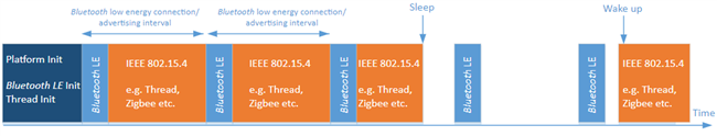

    When you use multiprotocol Zigbee and BLE, the radio hardware is time-sliced between the two protocols, and each radio protocol requests a timeslot prior to any radio operation.
    Because of the BLE protocol nature (TDMA), the BLE has priority over Zigbee. Therefore, any kind of application or Zigbee stack logic can be interrupted by the BLE activity, which can result in the node missing a frame and not responding with a MAC-level acknowledgment. You can read about this and other multiprotocol considerations here.
    This might affect your application and be a reason for why it doesn't send data request or wake, and then suddenly sends out multiple data requests. I'll need to research some more to figure out exactly what is failing in your application. Could you please capture a sniffer log of this happening and attach it here as a pcap file?
