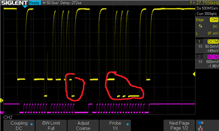

I2C GND Differs
I did some measurements today on our I2C bus and see that the GND level is different some times. The most time it is not GND level (about 800mV). I checked cross talk but dont see any reason and also it is perfectly timed. Has anyone an idea what could be the reason?
best regards
