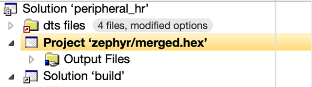

In my setup, the only project where the Options menu item is not greyed out is this one:
and the displayed window does not have a Code Generation and Optimisation selection.
So how do I set the optimisation?

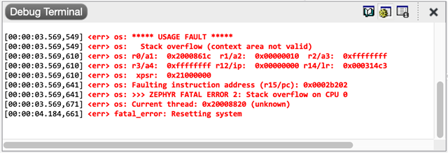

  • OK. So I've changed the optimisation in prj.conf to (and rebuilt the system):
    CONFIG_NO_OPTIMIZATIONS=y
    This change causes this crash:

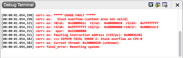

    Next, I changed the main stack size up in increments of 256 bytes. At 1536 bytes it still crashes:

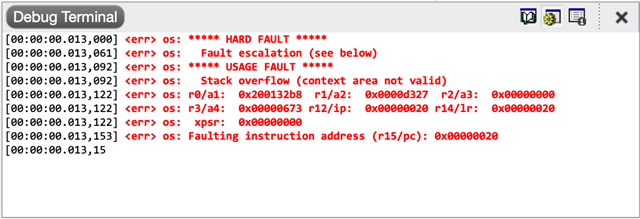

    Increasing it to 2048 bytes cases a hard fault:

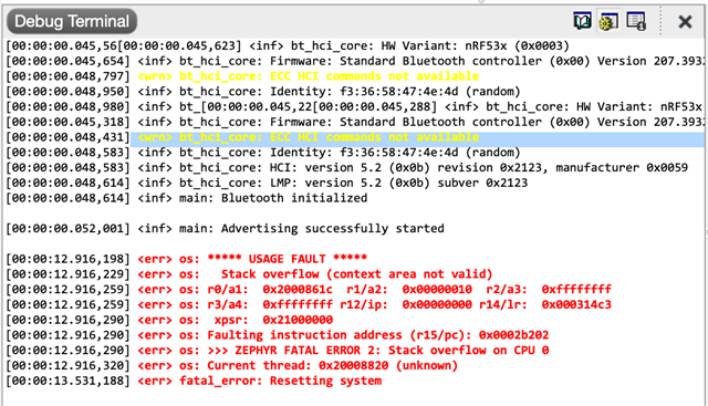

    I have tried your suggestion but, unfortunately, there is no change in behaviour.  I updated prj.conf as you suggested:
    CONFIG_MAIN_STACK_SIZE=4096
    CONFIG_BT_RX_STACK_SIZE=4096
    Then I quit SES, deleted the build folder to force a project rebuild then re-built the project for debug and ran it on the DK.  As you can see from the screenshot, I'm still getting a hard fault after a few seconds of running.

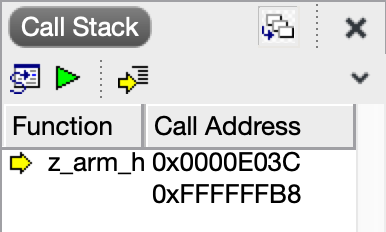

    There isn't much useful on the stack trace:
