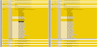

I found that the difference was adding FPU_irq_handler so the issue happens with the latest bootloader with custom FPU_irq_handler and the older version app without the handler.

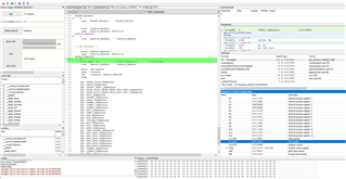

When I check the call stack, the point that the hang happened doesn't make sense and even if I remove the code, it still happens the next code which looks not related to the issue at all.
Also if I add custom FPU_irq_handler to the old app, the hang issue disappears.
So the only clue I found is FPU_irq_handler but I wonder if this vector table discrepancy can cause a hang or exception issue like this if so, why?

[call stack]
[map file compare old app vs new app]

  • Thank you for helping.
    I found the issue that bl enabled fpu irq and the newer app doesn't have a handler for it. So it went to the default handler with while loop.
