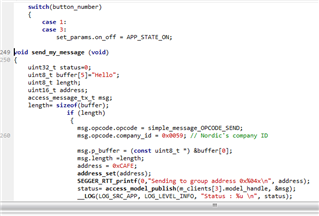

I have error on
simple_message_OPCODE_SEND
and
the address_set function
and also in the server side:
status= access_model_publish(m_server.model_handle, &msg);
I think there are some different in the new version of the nRF52 SDK for mesh V.5 I used.
Could you please help me on this topic.
Thank you,
Sama

    You should put the send_my_message() function outside the button_event_handler(). And the void address_set(uint16_t addr) can be added to main.c.
    Additional you should add these static variables and include as well in your main.c:

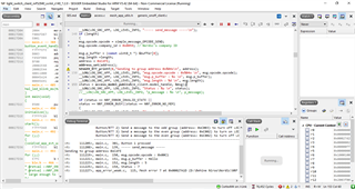

    The error that you get, Mesh error 7, corresponds to Invalid Parameter. In main on line 167, can you see which function is returning this error? Have you put in the correct parameter?
    Thank you for your reply.
    I tested that again, and it seems that the error is related to the invalid status in ERROR_CHECK(status);
    Here is the log and line that returned the error.
    <t: 0>, main.c, 431, ----- BLE Mesh Light Switch Client Demo -----
    <t: 12585>, main.c, 390, Initializing and adding models
    <t: 17486>, mesh_app_utils.c, 66, Device UUID (raw): 137FF47B11294702B381A62F60654E45
    <t: 17489>, mesh_app_utils.c, 67, Device UUID : 137FF47B-1129-4702-B381-A62F60654E45
    <t: 17506>, main.c, 478,
    Button/RTT 1) Send a message to the odd group (address: 0xC003) to turn on LED 1.
    Button/RTT 2) Send a message to the odd group (address: 0xC003) to turn off LED 1.
    Button/RTT 3) Send a message to the even group (address: 0xC002) to turn on LED 1.
    Button/RTT 4) Send a message to the even group (address: 0xC002) to turn off LED 1.
    <t: 150901>, main.c, 297, Button 1 pressed
    <t: 150903>, main.c, 139, ----- send_message -----
    Sending to group address 0xCAFE
    <t: 150914>, main.c, 151, Status : 7
    <t: 150916>, app_error_weak.c, 115, Mesh error 7 at 0x000279E5 (D:\Behine Niroo\Nordic\NRF Mesh\nrf5_SDK_for_Mesh_v5.0.0_src\examples\light_switch - Copy (3)\client\src\main.c:161)
    Because the status returned by the "access_model_publish" function, I printed out the parameters before that. As you can see

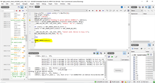

    <t: 0>, main.c, 435, ----- BLE Mesh Light Switch Client Demo -----
    <t: 12535>, main.c, 394, Initializing and adding models
    <t: 17432>, mesh_app_utils.c, 66, Device UUID (raw): 137FF47B11294702B381A62F60654E45
    <t: 17435>, mesh_app_utils.c, 67, Device UUID : 137FF47B-1129-4702-B381-A62F60654E45
    <t: 17449>, main.c, 482,
    <t: 111205>, main.c, 301, Button 1 pressed
    <t: 111208>, main.c, 139, ----- send_message -----
    <t: 111219>, main.c, 150, msg.opcode.opcode : 0x00C1
    <t: 111221>, main.c, 151, msg.p_buffer : Hello
    <t: 111223>, main.c, 152, msg.length : 5
    <t: 111225>, main.c, 154, Status : 7
    <t: 111227>, app_error_weak.c, 115, Mesh error 7 at 0x00027A1D (D:\Behine Niroo\Nordic\NRF Mesh\nrf5_SDK_for_Mesh_v5.0.0_src\examples\light_switch - Copy (3)\client\src\main.c:165)

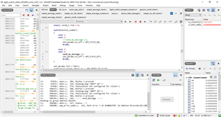

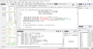

    I also followed the  "access_model_publish" function until "packet_alloc_and_tx" function and tried to print out its parameters:
    <t: 0>, main.c, 467, ----- BLE Mesh Light Switch Client Demo -----
    <t: 12356>, main.c, 426, Initializing and adding models
    <t: 12406>, main.c, 230, Node Address: 0x0002
    <t: 12409>, mesh_app_utils.c, 66, Device UUID (raw): 137FF47B11294702B381A62F60654E45
    <t: 12412>, mesh_app_utils.c, 67, Device UUID : 137FF47B-1129-4702-B381-A62F60654E45
    <t: 12436>, main.c, 514,
    <t: 178686>, main.c, 333, Button 1 pressed
    <t: 178688>, main.c, 139, ----- send_message -----
    <t: 178699>, main.c, 150, msg.opcode.opcode : 0x00C1
    <t: 178702>, main.c, 151, msg.p_buffer : Hello
    <t: 178704>, main.c, 152, msg.length : 5
    <t: 178706>, access.c, 439, handle : 0
    <t: 178708>, access.c, 440, pp_access_payload : 537128688
    <t: 178711>, access.c, 441, p_access_payload_len : 537128694
    <t: 178714>, access.c, 442, TX: Msg Hello
    <t: 178716>, main.c, 154, Status : 7
    <t: 178718>, app_error_weak.c, 115, Mesh error 7 at 0x00027A25 (D:\Behine Niroo\Nordic\NRF Mesh\nrf5_SDK_for_Mesh_v5.0.0_src\examples\light_switch - Copy (3)\client\src\main.c:165)
    I am not sure about the correctness of my method to print out and I could not print the "p_rx_message" variable.

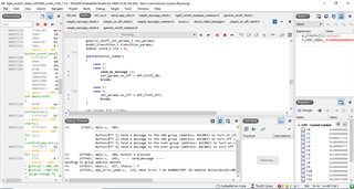

    Regarding the error 7, you probably haven't bound model to appkey or publish address haven't been set.
