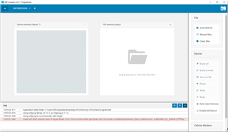

I still have issue with programming.
I don't understand why i always have trouble with DLL.
I'm able to program with SES, the bootloader and my application. But i also need to flash the softdevice and settings page. Usually i do it by using NrfConnect / Programmer.
But here it doesn't work any more.
It looks somthing related to the jlink i'm using, it is already up to date ( v6.82c). and driver are :
>nrfjprog --version
nrfjprog version: 10.8.0
JLinkARM.dll version: 6.82c
I'm supplying the DUT with 3.3V, 800mA output current regulator.
Jlink and my production board have gnd in common. I have disconnected the vdd of the jlink because i didn't trust it as it was 3.1V ( it seems to not be an official Jlink programmer).
What is strange is that with SES i have no issue to program.
Thank you
  • I succed also in programming my 4 .hex with nrfjprog command line, so i have doubt with nrfConnect/Programmer software.

  • Hi Florian
    In the latest nRFConnect updatest there have been a few compatibility issues with the nrfjprog version used alongside nRFConnect for Desktop, so there's likely an issue with the nrfjprog version you're using alongside nRFConnect. Try updating to a more recent version. The latest version should support nRFConnect v3.6.1,  but I see you're using v3.6.0, so you can try downloading nrfjprog v10.11.1 if you don't want to update your nRFConnect version.
    Best regads,
    Simon

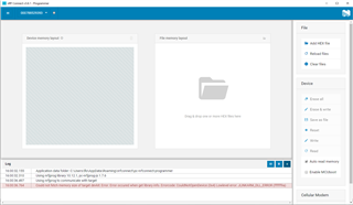

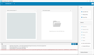

  • Hi Simonr, i have updated nrfConnect desktop to 3.6.1, same issue
    Here my version of nrfjprog:
    So i have updated to the latest 10.12.1, but same issue:
    hm hm Thinking
  • Hi
    Can you provide some more details about this J-Link device you're using? If it's not an "official" programmer as you say, that might be the reason it doesn't work with nRFConnect. Do you have a Development Kit available to test if nRFConnect works when using a DK? That should confirm whether the issue is with nRFConnect or the J-Link programmer/ the custom board.
    Can you also try doing an nrfjprog --eraseall on your custom board to check if "emptying" it makes any difference?
