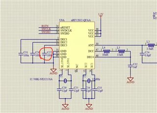

Dears ,
Is it possible to delete the C27 in order to reduce the area of layout as attachment for C27.
Thanks.

DEC3 is needed, DEC2 does not need a capacitor, so C26 in you case can be removed but C27 needs to be there.
https://infocenter.nordicsemi.com/topic/com.nordic.infocenter.nrf52832.ps.v1.1/ref_circuitry.html?cp=4_2_0_52_1#schematic_qfn48_dcdc
