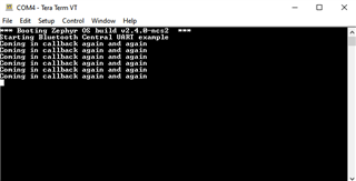

struct net_buf_simple *ad)
printk("Coming in callback again and again\n");

In peripheral_uart, we do not need to set the SCAN options. This issue is particular to this SCAN option only "BT_LE_SCAN_OPT_FILTER_DUPLICATE".
Yes, I have tested this on all versions v1.4.0 , v1.4.1, v1.4.2, v1.4.99-dev1.

Edvin,
For your reference, I have attached a zip folder which contains 2 code.
One is with config and other one is without config.
I have changed the scan.c file so that you can see the device address getting printed on terminal.
Please, replace my scan.c with the existing scan.c at this location ncs\v1.4.2\nrf\subsys\bluetooth and then try building the 2 code which I have attached.
In the code which does not have a config option set, you will see the same address getting repeated again and again even if the option is set to "BT_LE_SCAN_OPT_FILTER_DUPLICATE".
In the code which has config option set (CONFIG_BT_LL_SW_SPLIT=y), you will see that the same address does NOT appear again and again.
This is FOR STABLE VERSION V1.4.2
In order to test it, just run peripheral_uart code on 1 device and then on the 2nd device you can try the code attached in the zip folder. There is no need of "connecting" and "disconnecting". My problem has nothing to do with connections. It is regarding scanning

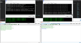

Ok, there are a lot of different versions and NCS branches going around here now, but now I ran your central_uart\without config, and a peripheral UART using NCS version 1.4.2, and I replaced the scan.c file with the above file. I only did one change to it, so that I could monitor the
callback in the RTT log rather than the UART log:
static void scan_device_found(const bt_addr_le_t *addr, int8_t rssi, uint8_t type, struct net_buf_simple *ad) { char devaddr[BT_ADDR_LE_STR_LEN] = {0}; bt_addr_le_to_str(addr, devaddr, sizeof(devaddr)); LOG_INF("Device Address %02x:%02x:%02x:%02x:%02x:%02x\n",addr->a.val[5], addr->a.val[4], addr->a.val[3], addr->a.val[2], addr->a.val[1], addr->a.val[0]); }
After applying this change, and flashing the two devices, this is the UART output and the log that I got from both devices. Peripheral on the left and central on the right:
Was the issue not that it kept receiving callbacks in scan_device_found without the config? If so, I can not see it in a fresh pull from the NCS v1.4.2 without further modifications than the scan.c file.
What am I looking for here? I assume the project "without config" is the one that contains the bug?
BR,
Edvin
