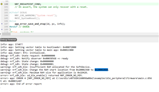

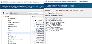

    So i have updated the NRF_SDH_BLE_GATT_MAX_MTU_SIZE in file sdk_config.h
    And i get an error on build:
    After updating the RAM start and size:
    I receive all my char !

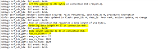

    Q1:But when i'm looking the log i see this:
    It works anyway...

    1. In the log you see that MTU is set to 247, but then, it go back to 27. It has no effect and works, but i'm surprised to see this.

    1. Aha, I understand. So, the data length can be changed by either the peripheral itself or by the peer. I assume that the app acts a central and would therefore have the final say regarding the connection parameters. A sniffer trace would clarify which device that asks for the change in data length.  The benefit of a small MTU is that it has less chance of interference. Interference would cause you to re-transmit the whole data pack, which is not good if you have a large data pack such as 247 bytes. It's therefore typical that the data length changes accordingly to the size of the data that is sent.
