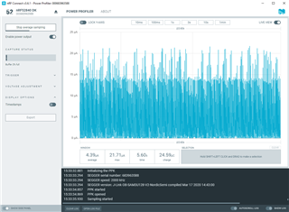

    Sorry. I was apparently a bit quick in the previous reply. HFCLKSTAT = 0x00010000 means that it is running on the RC oscillator, as you said. It is a bit difficult to debug this actually, since the internal HF oscillator is always running when the CPU is running. So whenever you hit a breakpoint, the CPU is running, and the HFCLK will be running as well. The only way to turn it off is inside the __WFE(), which you can't set a breakpoint to trigger. (setting it on __WFE() will of course trigger, but this would be before this is actually executed).
    There are a lot of peripherals and drivers (And obviously also libraries) that don't let go of the peripherals as they are supposed to when being disabled. So I started digging into this, and doing some measurements using the PPK.
    I saw that the current consumption went up to about 450µA when the sys_init() was called, as you said. So since the 802.15.4 is only using Timers and the radio, that was where I started looking.
    First, since it is easiest, I tried to turn off the power register in the radio peripheral using:
        NRF_RADIO->POWER = 0x00000000;
        while (NRF_RADIO->POWER != 0x00000000)
            // Wait
    right before the while loop:
        while (1)
            __WFE();
            // Clear the internal event register.
            __SEV();
            __WFE();
    This didn't seem to change anything regarding the current consumption, but I left it in for the rest of the test, so perhaps you need this one as well. You can experiment with removing this if you like.
    The next thing to test was the timers. Luckily it was the first one I tested, TIMER0 that seemed to be the issue.
    Since the power register of TIMER0 is not available like the NRF_RADIO->POWER register, we need to use it's address to turn it off:
        *(volatile uint32_t *)0x40008FFCUL = 0ul;
    After doing this, it looks like the current consumption dropped down to ~5µA:
    (there are current spikes, but the average is at 4.39µA)
    Give that a go, and let me know what you see.
    Edvin
  • Great !!!
    that was that. Thank You very much !
