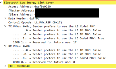

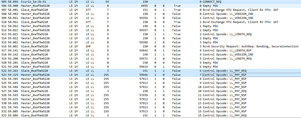

With the Windows laptop this goes as expected, and the connection changes the PHY to 2M. However, with the Laird dongle they get into this weird loop where the nRF is saying it prefers the 2M PHY and the PC says it prefers the coded PHY.
The whole exchange is included here. It appears the nRF is sending an LL_PHY_REQ but, for some reason, the PC is sending 4 identical answers LL_PHY_RSP.
The nRF sends this request, stating that it prefers 2M, as expected.
The PC answers with 4 identical packets (even the sequence number), saying that it prefers coded (not sure why). However, they never seem to agree. I'd expect the nRF to stop sending the request, because the PC is not offering 2M (not sure why).

    The 4 identical packets are simply retransmits, you can see the packet content and sequence numbers are not changed, so this means they are simply retransmits until the peer, in this case the nRF52, send anything in reverse direction to acknowledge the packet is received and the sequence numbers are incremented.
    In this case it does indeed look as you have a back-and-forth PHY update requests, so I suggest that you search through your project to find all instances where the sd_ble_gap_phy_update() may be called, likely you have some module in your application that cause this to be called more than once.

    I tried the setup again and this time, it works a little differently (not sure what changed, I'm on a different PC but everything is the same). Now, the nRF never answers. I only get a bunch of LL_PHY_RSP after the first and only LL_PHY_REQ. All the LL_PHY_RSP have the same sequential number. After 10 seconds, the communication stops; it would appear that a timeout expires on the nRF because it never got the expected answer. However, if this was the case, I would expect retransmissions, as in the original post.
    What event should the LL_PHY_RSP raise in the nRF? Is it possible I'm not answering and that's why it's retransmitting all the time?
    The LL_PHY_RSP packets have an incorrect CRC flag in the sniffer, is this relevant? Could they be malformed packets, and that's why the nRF never answers?
    This link shows a few communication diagrams, where it would appear that the Laird dongle is out of spec. When the Slave initiates the PHY change (6.31 - 6.33), the Master never answers LL_PHY_RSP, it can answer either LL_PHY_UPDATE_IND or LL_UNKNOWN_RSP. I have tested both these cases and they work fine: a BT5 laptop accepts and sends LL_PHY_UPDATE_IND to change to 2Mbps, a 4.0 dongle sends LL_UNKNOWN_RSP because it doesn't support PHY change. Could this be the issue?
    Thank you very much for your time
    Edit: all LL_PHY_RSP packets have the exact same (incorrect, according to wireshark) CRC. This would seem to discard an interference error, more like a systematic error on either the transmission or reception. Also, the LL_PHY_REQ that the nRF keeps sending are also retransmits (they have the same sequence number; the SN and ENSN seem to indicate that the nRF is not processing the LL_PHY_RSP)

  • Quickly looking at the screenshot it looks like the peripheral just stop responding, are you sure you are not having an assert? Maybe check the app_error_fault_handler() for any error?
    Kenneth
  • That would log an error to the debug console right? It would also stop execution on the NRF_BREAKPOINT_COND at the end of app_error_fault_handler, or reset the nRF. I can't see any of these things happening, execution seems to resume normally. What other condition could cause the nRF to stop transmitting altogether?
