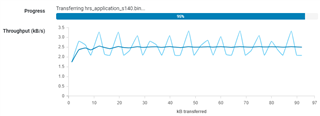

    I use BLE bootloader in SDK 17.0.2 and nRF Connect for Desktop app on windows to update with hrs application. I see the average throughput is around 2.4 kB/s.

    You could try the following, but I don't think that will improve a lot. I use J-link v6.88a and disable the mass storage device functionality to test SDK v14 BLE DFU update hr app to nRF52DK. I see the throughput is around 0.28kB/s in the ble app.
    -Amanda H.

    Unfortunately, your picture is not visible to me, but I'm also on J-Link v6.88a.
    I have tried to follow your steps but the throughput stays the same. Small note, after updating the J-Link firmware version (from here), the nRF52 DK again shows up as MSD. So I guess disabling the MSD should come after updating the firmware? Or did you not mean to follow those steps sequentially?
    In any case, it seems that I'm stuck with slow drivers/hardware then. Since this was not really an issue but more a question to try and understand what's going on, I'll close my question and mark your response as the answer.
