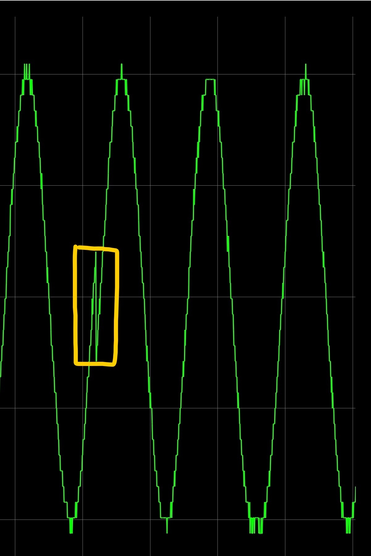

I'm using nrf52 with s132(v17.0.0).
When I connect nrf52 with my phone, there is error like this picture.

When the buffer is filled, then next buffer is filled by ADC value.
I guess the problem occurs at this time.
Also, when I use printf function to see value in PC, same problem occurs.
How can I solve this?

    What is the axis labels here? Please include more of the image. Without the axis' labels and magnitudes it is very hard to say anything about what this is depicting.

    First of all, I attached screenshot picture which means Xaxis label(1st buffer, 2nd buffer).
    I applied sine graph.
    In one buffer([0, ~ , 239]), there are linearity. And I can get sine graph so exactly.
    But when the buffer is changed, the problem occurs.
    There are no linearity.
    I guess the reason happens in changing buffer ( [0, ~ ,239] -> [0, ~ 239] ).
    And I'm using PPI to use SAADC function.
    I attached the code.
    Thanks
    Thank you for clarifying.
    Is the graph here from the values that the phone is receiving - i.e the phone is creating this graph to display the values it is getting, or is this a graph generated to illustrate the issue from the outputted SAADC values directly(no phone involved)? If there is a phone involved - could you tell me which BLE connection parameters are you using?
    How is this graph generated, and could you show me the raw output of the SAADC instead?
    I suppose the resolution of your graph is a little low, but it seems that the first value of the second buffer somehow is equal to the second last value of the first buffer.
    Since you are using double buffering the SAADC will immediately continue to sample into the next buffer once the first buffer is filled - so there will be no computational time necessary here before sampling resumes. This way, you will not miss a single sample.
