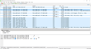

Hello
I am contacting you because I have a problem with the "otThreadSendDiagnosticGet()" function.
In my program, I am trying to retrieve the list of RLOC16s of the children of all the routers in the Thread network.
My problem is that the "otThreadSendDiagnosticGet ()" command works once after it doesn't work anymore.
For example, if I have a network with a Leader and 2 routers:
  1. I get the RLOC16s from the routers on the network via the function "otThreadGetRouterInfo (thread_ot_instance_get (), i, & routerInfo)" (i is the index in the router table)
  2. I send the command "otThreadSendDiagnosticGet ()" to the first router on my list and wait for the response.
  3. When I received the response, I send the command "otThreadSendDiagnosticGet()" to the second router ... -> but here I have no more response
Do you have any idea why my other requests are not sending? (whereas if I send normal requests (requests to the "light" resource for example) in addition to diagnostic requests, these requests have no problem and go correctly)
Thank you

  • Hi
    Yes it works if I test with the second router instead of the first.
    In addition, if I send the same request to the device that was working, the second request is not sent (although there is no error returned by the functions).
    I am using the nRF5_SDK_for_Thread_and_Zigbee_v4.0.0 version with the thread_cli_ftd_uart_pca10056 example.

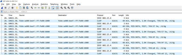

  • Not sure why it does not work for you, maybe there is something wrong with how you call the function, or on the node that receives the request.
    I did a test on my own, and I have no problems with sending multiple diag requests:
    I used nRF5 SDK for Thread and Zigbee v4.1.0, and the simple_coap_server example for my test. Attaching main.c that you can use to test this on your own:
