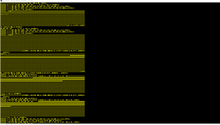

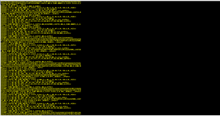

Dear Members,

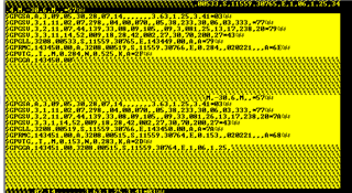

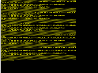

How can i keep the data no being cut ?
before using call back function ,
after using call back function :
function :
call back from main :
 case NRF_LIBUARTE_ASYNC_EVT_RX_DATA:
					   //nrf_libuarte_async_tx(&libuarte, text2, text_size2);
				    //nrf_libuarte_async_tx(&libuarte, p_evt->data.rxtx.p_data, p_evt->data.rxtx.length);
				    GPS_CallBack();
Call back and process function :
void	GPS_CallBack(void)
	GPS.LastTime=nrf_systick_val_get();
	if(GPS.rxIndex < sizeof(GPS.rxBuffer)-2)
		GPS.rxBuffer[GPS.rxIndex] = GPS.rxTmp;
		GPS.rxIndex++;
		memcpy((void *)line_buffer_GPS, GPS.rxBuffer, GPS.rxIndex);
   nrf_libuarte_async_rx_free(&libuarte1, (uint8_t *)&GPS.rxTmp, 1);
void	GPS_Process(void)
	nrf_libuarte_async_tx(&libuarte, (uint8_t*)line_buffer_GPS, sizeof(line_buffer_GPS));
What do I miss here ? a size of data ?
