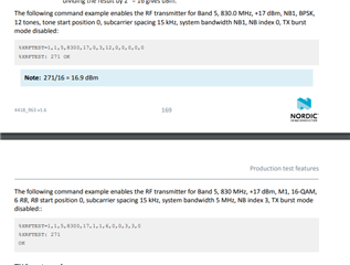

    it depends on what you use in the parameters. The white paper contains examples:
    And yes to stop the constant carrier you need to stop it, sending TX off.
