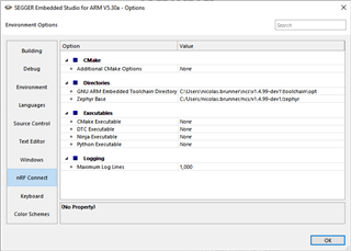

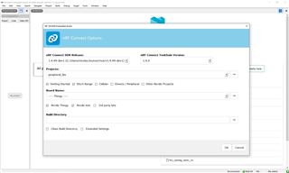

Unable to compile cdc_acm with SES 5.30a
Hello, i'm trying to build zephyr\samples\subsys\usb\cdc_acm but i get the following error:
1> zephyr/isr_tables.c does not exist.
1> Combining ‘zephyr/isr_tables.c’
1> C:\Users\nicolas.brunner\ncs\v1.4.99-dev1\toolchain\opt\bin\arm-none-eabi-objcopy.exe: unrecognized option `--output-source'
1> C:\Users\nicolas.brunner\ncs\v1.4.99-dev1\toolchain\opt\bin\arm-none-eabi-objcopy.exe: supported targets: elf32-littlearm elf32-littlearm-fdpic elf32-bigarm elf32-bigarm-fdpic elf32-little elf32-big srec symbolsrec verilog tekhex binary ihex plugin
Build failed
With an older SES (5.10d), i have no error during the build.
  • Apparently SES 5.30a doesn't like to have a "cd" in the project name.
    I have also observed that a folder "_acm" appeared to the root of my NCS folder after the failed compilation.
    I'm currently looking into this. Can you provide more information on your environment? Are you able to provide a full log output from SES? Are you able to build projects using west? I.e. from Toolchain Manager, open bash and try building a project using west?
    Edit: What device are you building for?
    Thanks!
    Øyvind
  • My OS is Windows 10 Entreprise and I'm using NCS 1.4.99 with nRF5340DK. I have the same problem when trying to build for NCS 1.4.0 or nRF52840DK. Here is the log:

  • Can you please provide screenshots of the "Open nRF Connect SDK project" and Tools -> Options -> nRF Connect?
    I am not able to reproduce with Toolchain Manager NCS 1.4.99-dev1.
     As each install of NCS versions are standalone, sandbox solutions, you should not see this in both NCS 1.4.0 and 1.4.99-dev1. When installing each, are you on VPN or similar?
    -Øyvind
