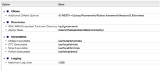

I have installed the toolchain according to nRF Connect guideline, on my MAC OSX.
My option settings are listed in the attached image.
I downloaded release 1.4.2.
When I open a project to evaluate my nRF5340 PDK, I get this error:

I do not understand where it fails...
