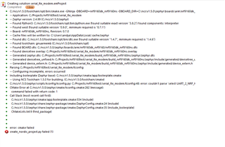

I'm using NCS 1.4.0 and SES. If I change the setting in Serial LTE modem to  CONFIG_SLM_CONNECT_UART_2 for external MCU connection, I get an error msg from SES: Cannot configure project. It works fine with UART_1. Everything else is unchanged. Am I missing something? Should I configure something else? anybody else getting the same error?

  • The issue is UART_2_NRF_HW_ASYNC_TIME which is set at the same time as SLM_CONNECT_UART_2, is not configured with a value. I am currently working on a work-around.
  • Please try setting the UART_2_NRF_HW_ASYNC_TIME=2 manually in menuconfig in SES. This worked for me. This is the only work around at the moment.
  • Hi Oyvind, I'm having trouble with the same issue.  But after I set the UART2 for the first time, the menuconfig never loads again.  Can you walk me through how to manually change these parameters?
  • Here is what I get after changing config to UART2
