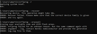

Lately I have been using a PCA10040 (nRF52-DK) with J-Link OB-SAM3U128-V2-NordicSem V1.00 version.
I'm trying to program two boards one with nRF51822_xxAA and the other with nRF52832_xxAA.
It seems there is no problem to program the nRF52 board using J-LINK V6.94b and nRF Command Line Tool 10.12.1. Can program, recover and erase all with no problem.
But when I try to use it with the nRF51 board it seems like not working or randomly working.
I need help with this, how to solve this issue since I need to use PCA10040 for nRF51 and nRF52.
Thanks a lot.
    Can you first try to add the --family NRF51 option when you run commands for the nRF51 device, to see if it works when the family is manually provided?
    If that does not work, please add the --log flag to the commands, and provide the resulting log.log file. If you run several commands, then the log.log file may overwrite, so then it is best to provide a file name, e.g. --log recover.log will write the log to a file named recover.log.
