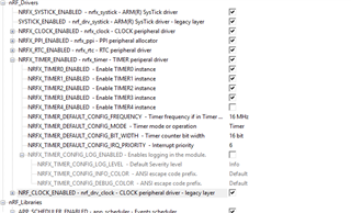

Timer0, Timer2 value = ?
Dear Members,
NRF_LIBUARTE_ASYNC_DEFINE(libuarte, 0, 0, 0, NRF_LIBUARTE_PERIPHERAL_NOT_USED, 255, 3);
NRF_LIBUARTE_ASYNC_DEFINE(libuarte1, 1, 2, 2, NRF_LIBUARTE_PERIPHERAL_NOT_USED, 255, 3);
as define on NRF_LIBUARTE_ASYNC_DEFINE(_name, _uarte_idx, _timer0_idx,\
                                  _rtc1_idx, _timer1_idx,\
                                  _rx_buf_size, _rx_buf_cnt)
I used timer0 and RTC0 for UART0 and
RTC2,timer2 on UART1
How can I now the value of timer0,RTC0 and RTC2,Timer2 ?
is it 100mS each ?
Thanks

  • Thanks for the reply Einar,
    Will the timer effect "Event handler" of my UART ?
    When I use callback function, the message from UART1 is cut .
    case NRF_LIBUARTE_ASYNC_EVT_RX_DATA:
                      //nrf_libuarte_async_tx(&libuarte, p_evt->data.rxtx.p_data, p_evt->data.rxtx.length);--> with this function --> the messages are good
                       GPS_CallBack(); ---> with this function, a lot of messages in buffer are gone
    is it because of the timer ?
