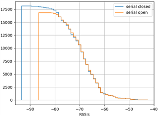

  • I apologize for the delay, but I did want to update you (and this thread in case others see something similar).
    We were unable to reproduce the issue on the dev kit and were initially confused by this.
    Eventually we found that the module (& its slightly different antenna) we were using allowed us to capture lower-energy packets than the dev kits. It appears that the difference in received packets was entirely in these lower-energy packets, so the dev kits don't exhibit any change in behavior.
    It is still clear that there _is_ something about opening a usbd port that damages our ability to receive packets. Based on what we've seen I'm guessing that we're effectively raising our noise floor one way or another. No particular theory on if the usbd is causing noise that couples in, causing thermal noise, or something else.
    This plot clearly shows the effect mentioned. It should be read as "How many packets were received in an average minute at this RSSI or higher". As you can see, all the differences are on the lower end of RSSIs, which is why it cannot be replicated on a dev kit.
    For our application, we believe we will be able to tolerate this behavior, but it's still surprising and, perhaps equally important, _different_ from the behavior seen when UART is used instead.
