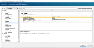

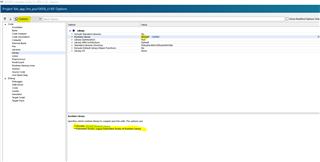

I`m getting very different results from asinf() in math.h provided by Segger, depending on the usage of the hardware FPU.
When ARM FP ABI Type is set to hardware, the function is not returning correct values.

As you can see, asinf is not behaving as it should when using the hardware FP option. Is there something else I could have missed? Or should I ask Segger about it?
(nRF52840, SES 5.40 with included gcc compiler, also in 5.30)
