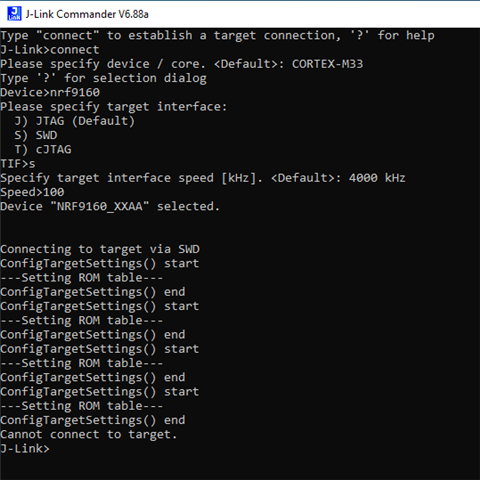

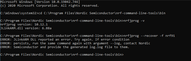

    Yes, I am able to connect to the Thingy:91 with the nRF Connect Programmer, but I get the error "Failed to connect to target. No idcode detected. Please check connection and Target Interface Type" when selecting the "build and run" option under the build section on the toolbar.
  • I have been doing some research on my own regarding this issue as well and just wanted to update you to a few new things.
    One of the common things that I have seen to try are (1) testing the nrfjprog --recover command and (2) following the troubleshooting steps found here: https://wiki.segger.com/J-Link_cannot_connect_to_the_CPU
    The results to those two main steps are shown below in the 2 images:
    Hope these are helpful!
