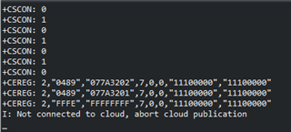

  • Hi Marte
    I have tried the cloud client sample but don´t connect, I wait for 10-15 minutes but not connect I don't modify any thing and do the same proccess that with others samples to download to board, maybe I need wait more time?
    what protocol of transsmision use cloud client?
    thanks
    Is your device already set up with your nRF Cloud account? The default cloud backend is nRF Cloud, so the sample will try to connect to nRF Cloud. However, your device must be in your nRF Cloud account already, like when you add it using the Asset Tracker application. You can also change the backend to AWS IoT or Azure IoT Hub, but then you'll have to configure ID, hostname, etc. in prj.conf yourself.
    All of the cloud backends use TLS secured MQTT as communication protocol.

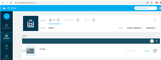

    Yes I have set up the device with my nRF Cloud account, I did it once for run the asset_tracker sample

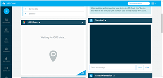

    I understand the transmited messagge apear in this terminal, is that rigth?
    the cloud bakend is NRF_CLOUD

  • I just resolved it, the problem is the new sim
    Great to hear that the problem was resolved!
