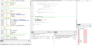

    Thank you for the perfect explanation, I have integrated the peer manager like from "ble_app_template" application. but i'm not able to make it bond, when i click pair option from discovered list in mobile, firmware is crashed in SDH (nrf_sdh_ble_evts_poll()), if i change the NRF_SDH_BLE_SERVICE_CHANGED macro to 1 in sdk_config.h any additional configuration or modification need to do?
    When i try to change add_char_params.cccd_write_access=SEC_JUST_WORKS from SEC_OPEN, my UART communication is crashed.
    Please help to achieve the pairing/bonding for the secure communication.

  • Hello Thiru,
    Do you see any logging from your project? I see that you use Segger Embedded Studio. Try adding DEBUG to your preprocessor definitions:
    Then you should monitor your log (everything printed by NRF_LOG_INFO()). By default, this is printed on the UART backend. After you added DEBUG to your preprocessor definitions, you should see the log pointing at an APP_ERROR_CHECK(err_code) in your project. What was the err_code, and what function returned that value?

  • Hi Edvin,
    I got your point, But i have used the UART for some other purpose, i cannot redirect the debug logs into UART. is there any other way to see the logs?
