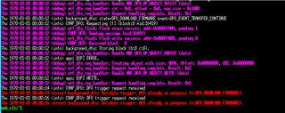

    In a working case - where DFU completes successfully and a new image boots. After successful completion of DFU image transfer, DFU client node is reset. After Node reset  - I don't see any boot loader logs. I've to exit from JlinkExe process and reconnect with the device to get logs again. Now if I wait for sufficient amount of time - around 30 seconds, I get logs from new image.
    If I don't wait for 30 seconds and immediately exit from JlinkExe process and connect with the device - I get boot loader logs but device firmware is not updated. I'm attaching logs for this case. By looking at logs - can you make sense of what's going wrong ?
    <info> background_dfu: state=DFU_DOWNLOAD_FIRMWARE event=DFU_EVENT_TRANSFER_CONTINUE
    <info> COAP_DFU: Requesting [f] (block:3762 mid:61189)
    <info> background_dfu: Storing block (b:3762 c:3762).
    <info> nrf_dfu_flash: nrf_fstorage_write(addr=0x000E5900, src=0x200093B0, len=92 bytes), queue usage: 1
    <info> nrf_dfu_flash: Flash write success: addr=0x000E5900, pending 0
    <info> nrf_dfu_validation: Hash verification. start address: 0x70000, size: 0x7595C
    <info> nrf_dfu_validation: result of Hash Verification 1
    <info> nrf_dfu_validation: Control is here .....is_trusted 0 ret_val : 1
    <info> nrf_dfu_validation: setting current Bank to 1
    <info> nrf_dfu_req_handler: res.result : 1
    <info> nrf_dfu_req_handler: After -- res.result : 1
    background dfu handle event
    <info> background_dfu: state=DFU_DOWNLOAD_FIRMWARE event=DFU_EVENT_TRANSFER_COMPLETE
    background dfu handle event : background dfu download firmware
    <info> nrf_dfu_settings: crc : 52A322F8,bank_c<info> nrf_dfu_settings: Erasing old settings at: 0x000FF000
    <info> nrf_dfu_flash: nrf_fstorage_erase(addr=0x0x000FF000, len=1 p<info> nrf_dfu_flash: Flash erase success: addr=0x000FF000, pending 0
    <info> nrf_dfu_flash: nrf_fstorage_write(addr=0x000FF000, src=0x20006C78, len=896 bytes), queue usage: 1
    <info> nrf_dfu_flash: Flash write success: addr=0x000FF000, pending 0
    <info> COAP_DFU: Reset after DFU

    <info> nrf_dfu_flash: nrf_fstorage_erase(addr=0x0x000FE000, len=1 pages), queue usage: 1
    <info> nrf_dfu_flash: Flash erase success: addr=0x000FE000, pending 0
    <info> nrf_dfu_flash: nrf_fstorage_write(addr=0x000FE000, src=0x20000CA0, len=896 bytes), queue usage: 1
    <info> nrf_dfu_flash: Flash write success: addr=0x000FE000, pending 0
    <info> nrf_dfu_flash: nrf_fstorage_erase(addr=0x0x00069000, len=8 pages), queue usage: 1
    <info> nrf_dfu_flash: Flash erase success: addr=0x00069000, pending 0
    <info> nrf_dfu_flash: nrf_fstorage_write(addr=0x00069000, src=0x000D8000, len=32768 bytes), queue usage: 1
    <info> nrf_dfu_flash: Flash write success: addr=0x00069000, pending 0
    <info> nrf_dfu_settings: crc : C042BA13,bank_current : 0
    <info> nrf_dfu_flash: nrf_fstorage_erase(addr=0x0x000FF000, len=1 pages), queue usage: 1
    <info> nrf_dfu_flash: nrf_fstorage_write(addr=0x000FF000, src=0x20001020, len=896 bytes), queue usage: 1
    <info> nrf_dfu_settings: Backing up settings page to address 0xFE000.
    <info> nrf_dfu_settings: Erasing old settings at: 0x000FE000
    <info> nrf_dfu_flash: nrf_fstorage_erase(addr=0x0x00071000, len=6 pages), queue usage: 1
    <info> nrf_dfu_flash: Flash erase success: addr=0x00071000, pending 0
    <info> nrf_dfu_flash: nrf_fstorage_write(addr=0x00071000, src=0x000E0000, len=22876 bytes), queue usage: 1
    <info> nrf_dfu_flash: Flash write success: addr=0x00071000, pending 0
    <info> nrf_dfu_settings: crc : DA92FEEA,bank_current : 0
    <info> nrf_dfu_settings: crc : 5DCA91E4,bank_current : 0
    <info> app: Inside main
    <info> nrf_dfu_settings: settings_valid : 1 settings_backup_valid : 1
    <info> nrf_dfu_settings: crc : E4 91 CA 5D
    <info> nrf_dfu_settings: Returning from reinit - bank_current : 0,crc : 5DCA91E4
    <info> nrf_dfu_settings:  err_code : 0
    <info> app: ret_val 0 of nrf_dfu_settings_init
    <info> app:  s_dfu_settings.bank_current : 0
    <info> app: No firmware to activate.
    Exiting immediately and reconnecting with the device is the only way to get boot loader logs.
  • I'm a bit confused by the log. It looks like it is copying the new firmware, is this not the case?
    There seems to be some glitching or missing logs around line 41-42, so it is a bit hard to see exactly what happens. Disabling logging in the application should help you get all logs from bootloader. You may also configure the RTT to ble blocking if buffer is full, to make sure you get all logs.
