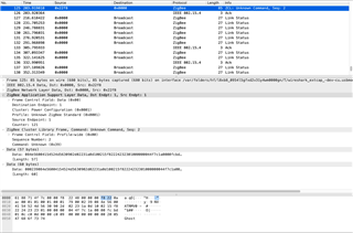

We have a Zigbee device that doesn't seem to use ZCL to transfer data and I have been trying to see if there is a way to get it working with an nrf52840 acting as a coordinator. The device successfully authenticates and starts sending data that I can see using Wireshark. Wireshark complains about the ZCL data and when I look at that part of the packet I can tell it is actually the specially encoded data coming from the device and doesn't look like it fits the ZCL specification at all. I think if I could just access the APS data directly that would be all I need since the device encoding is already something we handle with other coordinators. Is there a way to access the incoming APS data directly?
The following is an example packet capture from Wireshark showing the data in question:
0000 61 88 27 21 74 00 00 1c 4c 48 00 00 00 1c 4c 0a a.'!t...LH....L.
0010 15 00 01 01 00 01 00 01 1e 00 02 39 08 4e 56 00 ...........9.NV.
0020 41 41 41 41 41 30 90 2d 02 09 26 0c 0a 02 15 1c AAAAA0.-..&.....
0030 4c 24 23 23 01 00 00 00 04 21 74 1a 00 00 fc d1 L$##.....!t.....
0040 01 0c f3 0d 00 00 44 08 00 00 00 00 00 00 20 05 ......D....... .
0050 47 68 6f 73 74 Ghost
The device always uses endpoint 1, cluster 1, profile 1. What should be the ZCL frame is specially encoded data from the device.

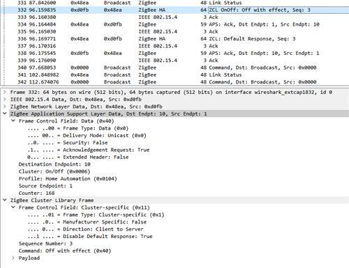

    As for the sniffer log it would help to get the pcap file, or a picture of the packet itself if the former isn't possible. The part you've already added here doesn't tell me much, and it would help to get something that gives more information about the packet, such as showing the application layer, and the cluster library frame if it's a Zigbee HA packet, like shown below.

    Here is a screenshot of the data in question:
    I'm sorry for the late reply. I've asked our Zigbee team internally about your issue, and I'll come back to you when I get a response from them.
    Marte
    I got the Zigbee team to look at the screenshot of the sniffer log. It is not ZCL that's the problem, but the profile ID (0x0001), which is not recognized by the stack. In such situations, the only solution is to use the zb_af_set_data_indication API.
